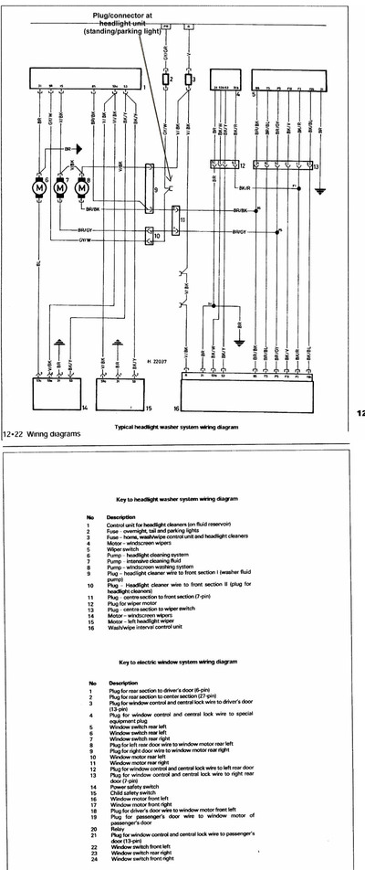

Study the wiring diagram near the end of this page first.

How the system is supposed to work
References are to that diagram. This is a working model of the control units, not a factory description of what is inside them.
- Terminal PS on the service-wash button is connected to the intensive-cleaning-fluid pump (7) and goes to ground via TS to run it.
- That ground via TS is through the wash/wipe interval control unit (16). A timer there holds the earth on PS long enough to run the intensive pump.
- Current through the intensive pump triggers the headlight-cleaner control unit (1), which then:
- Follows the intensive wash by switching on screen wash for a timed interval (earthing 85)
- Switches on the headlight wipers
- Which triggers the headlight wash

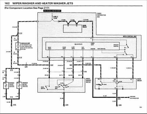

US ETM wiper/washer (no headlight wash/wipe):
