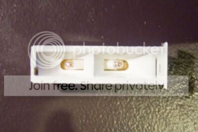

OBC bulb / light bar
The display is lit by a light bar that slides into the upper right corner of the OBC. Needle-nose pliers make it a snap to replace. If the readout is dim or faded, replace the light bar rather than looking for internal batteries.
OBC light bar. It slides into the upper right corner of the unit.
